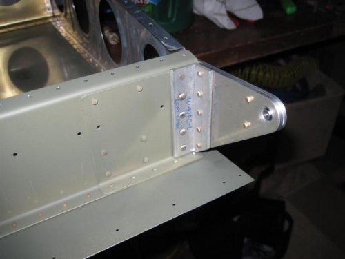

Failed to use the shorter rivet on the outside part of the hinge that rivets to the rib rather than the spar, so had to drill three of them out and redo. Wondered why the tops were bending over instead of mushrooming properly. Now, they look good.
Inboard aileron hinge in place.

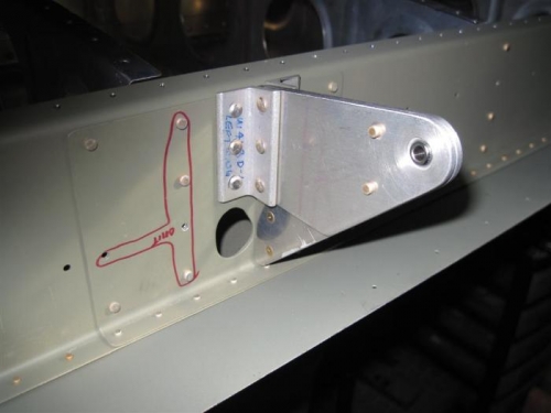

Outboard aileron hinge in place.

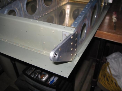

Other side of the outboard aileron hinge.
