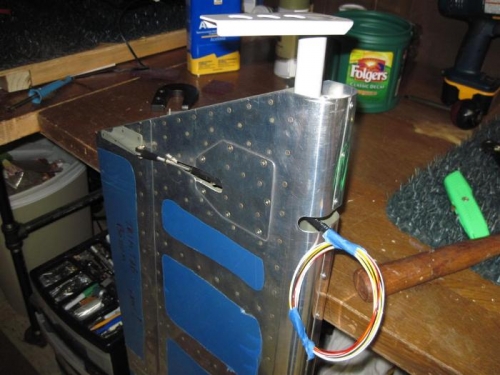

Brief Description:  Extended wiring from elevator trim servo
While waiting for a chance to have someone (Steve) get on the other side of the wing to rivet the top skins, I thought this would be a good time to attach longer wire leads to the elevator trim servo, so I could tighten the screws in place and forget about it. So, I got some wire, matched the colors as closely as possible, and added about 3 feet to each servo lead. Then put heat shrink tubing over each soldered wire connection, then larger heat shring tubing over the whole thing. Came out pretty decent.

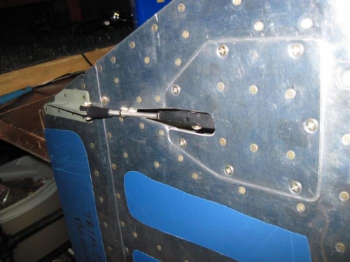

Then I replaced the servo inside the left elevator and tightened all the No. 6 screws. I have been told that the No. 6 screws are treacherous, as they shear off easily because it is easy to over torque them, so tightened them very carefully. All came out OK.
Additional wiring extended from servo leads.
Servo mounted in left elevator.
