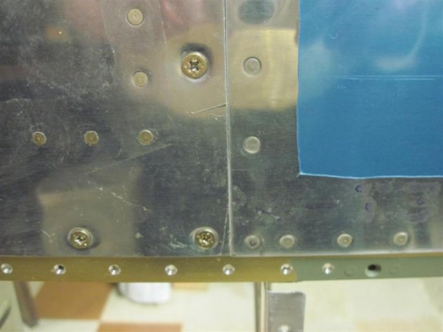

Brief Description:  Finished attaching leading edge and tank to left w
I had riveted part of the left leading edge to the spar night before last, got tired and left it for tonight. The rivet in the corner next to the tankhad to be driven due to being up next to a plate nut on the inside of the spar; all the rest were able to be squeezed. Looks good. I have to bevel the corners of the top main skins where they overlap, and dimple them, then will be able to rivet them and get the wing off the jig, so I can bring the right one up to where this one is.
Bottom joint fits pretty good.
Top one looks even better.
