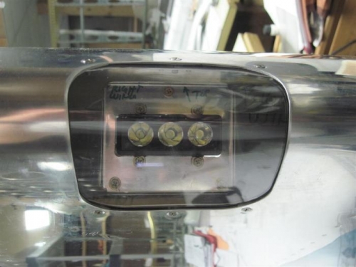

Today I took a short nap after church, then got started on the continuation of the right landing light. It seems like forever since I have had more than a few minutes to think about the project, let alone get anything done. So, with the Masters on TV going over in the corner, I got the plexiglass lens drilled and fitted to the wing opening that I cut a week or so ago. After that, I mounted the light to the adjustable bracket that I built when I did the left wing light, which seems like forever. I put the insulating tape around the inside of the hole and screwed the plexi into place. Fit very well, a little more snug than the left one. I may redo the plexi on tne left one, but not right away.

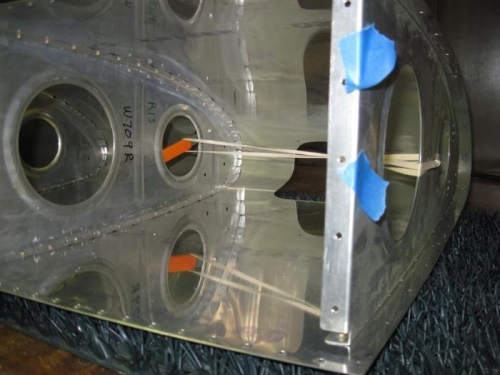

A pretty handy third hand when drilling for the nutplates for the light mounting bracket.
Finished right landing light.
