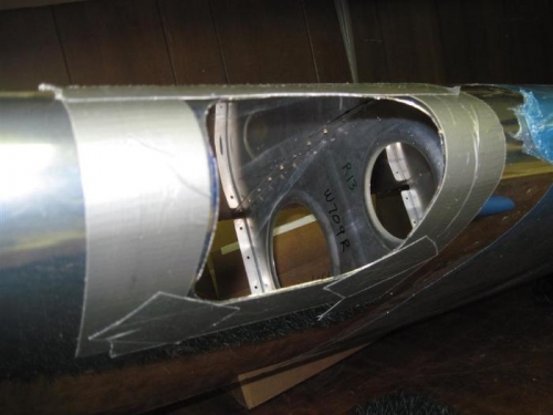

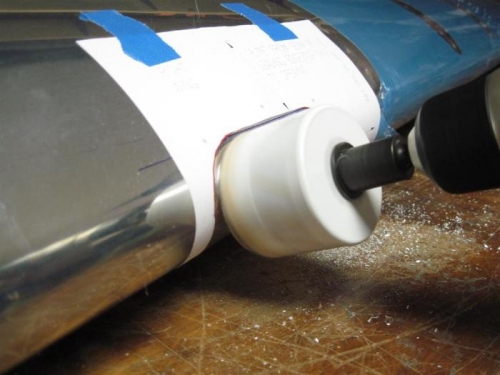

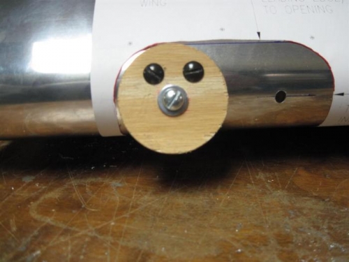

Tonight I laid out the hole in the right leading edge, and started cutting it out. I used a 2.5" hole saw like last time, and managed to get t pretty decent cut. I had already built the light mount when I was doing the left wing, so this should go a little quicker.
After cutting the radiused corners, I cut the lines between them with a saber saw, then did the file, sandpaper, and scotchbrite thing. Came out pretty well overall.
The wood disc
The wood disc "smiley face" to guide the hole saw.
Cutting the corner of the outlet.
Decent looking hole
Decent looking hole
