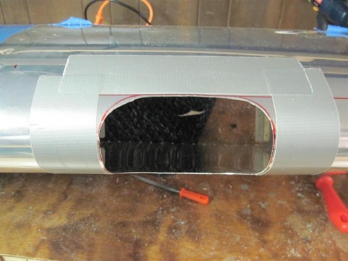

Brief Description:  Continued with the landing light cutouts

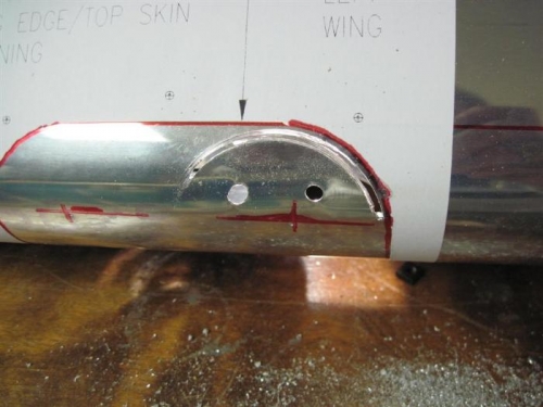

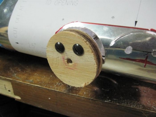

The corners at the top of the leading edge cutout were a little more difficult due to the profile of the leading edge. To compound matters, the drill walked a little bit while drilling the disc mounting holes for the top left corner, thus the disc, and the hole, were too low. In hindsight, I could have slotted the hole, but didn't think of it then.
This left me with a lot of filing to do.
First top corner came out pretty close to where it needed to be.
The drill
The drill "walked" a little bit when drilling the holes to mount the disc, thus the hole came out low.
Got a lot of filing/cleaning up to do with this corner.
