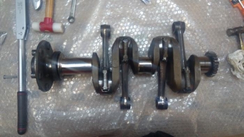

Today, Burak and I finished connecting, torqueing and cotter pinning the connecting rods to the crankshaft of my Continental C90-8F. Only two of the bolts were needed to be torqued slightly above 400 in-lbs.
First bolt torqued
All conrods attached to crankshaft
