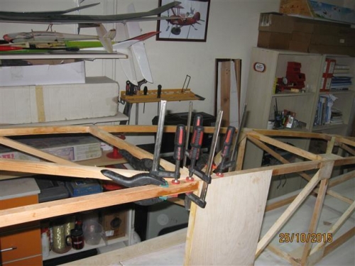

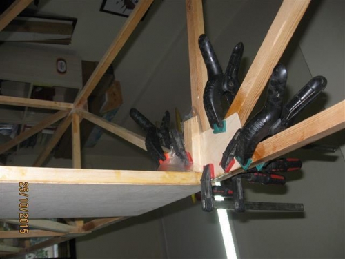

I sanded and checked the surfaces where ply will go. I also checked the squareness of the frame at firewall and found it to be off square by 3mm (1/8"). I trial fitted the squared firewall and found that it can easiliy be corrected so, no problem. I also epoxied one of the guessets to go on rear seat back, upper joint. By next weekend I hope to have done some work on the landing gear. In the meanwhile, a good friend who is building a Cosy MK IV had a flight to US ( he is a THY captain) and brought 4130 tubing for his motor mount, which I will build, and most of my turnbuckles, pins and shackles from Aircraft Spruce. I already have the nicopress sleeves, thimbles and wire for controls.
Rear seat upper guesset
Rear seat upper guesset again
