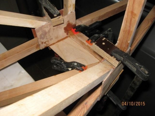

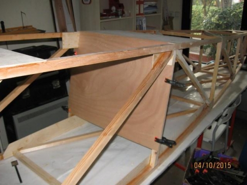

I cut and shaped the plot seat back. I also cut and shaped the bottom rear ply cross brace for the fuselage bottom and epoxied it in place.

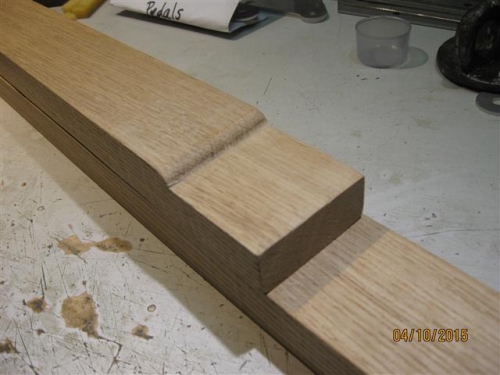

Finally I found appropriate wood for the two cross members in between landing gear supports. The wood is domestic Oak, whick is very strong and has good grain structure. I started to shape the ends to about 3/4' (20mm) height.
Pilot seat back
Pilot seat back
Rear bottom guesset
Rear bottom guesset
End of one Oak cross member
