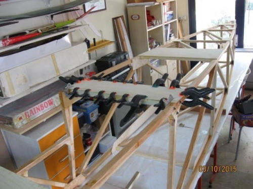

I cut, shaped the 1/8" plywood for the pilot instrument panel floor and epoxied it in place.

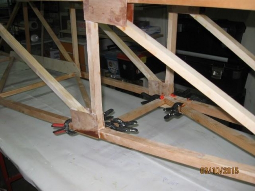

I also cut the two rear ply guessets for the fuselage bottom and epoxied them in place.
Pilot instrument panel floor
Rear bottom guessets
