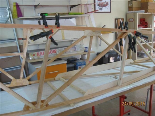

Date:  9-24-2015
Number of Hours:  4.00
Brief Description:  Fuselage work

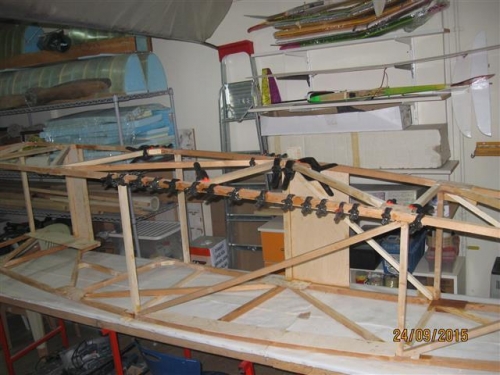

I prepared and epoxied three more guessets on the fuselage. I know the work is a bit slow but I prefare to do one side at a time to prevent epoxy from seeping down. After finishing epoxxying the guessets, I turn the fuselage 180 degrees so the guessets go to the bottom. This way, any epoxy which overflows form a nice fillet instead of flowing down the spruce member.
More guessets
More guessets
sTILL MORE GUESSETS
sTILL MORE GUESSETS
