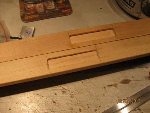

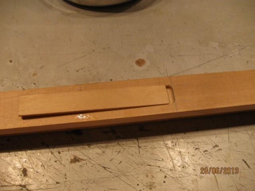

Recesses for 3mm aircraft ply tail hinge reinforcements were milled. Reinforcements are cut from 3mm ply. Recesses cut on a milling machine.
Hinge reinforcement recesses
3mm ply reinforcements

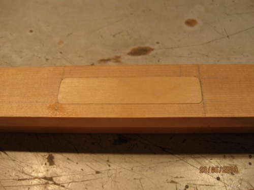

Reinforcement epoxied in place
