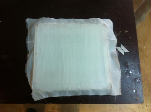

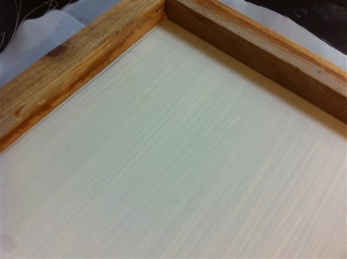

Brief Description:  Fabric adhesive and Acrylic water based paint test
We made a square frame from scrap wood and glued dacron fabric (Aircraft Spruce) on it. We used locally obtained water based polyurethane glue. When Glued, we stretched the fabric with a simple iron. Then we applied two coats of the paint on the fabric. The result is highly satisfying. More on the subject later.
Outer face
Outer face
Inner face
Inner face
