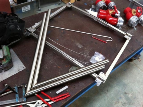

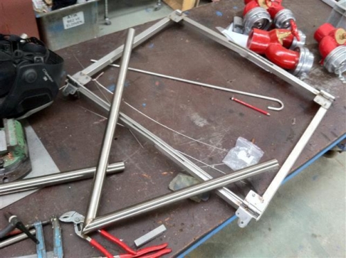

Landing gear vees
We adjusted the vise on the milling machine to correct angle and milled the ends of the V tubes. We tack welded them an tested against my building jig. They turned out to be ok.
