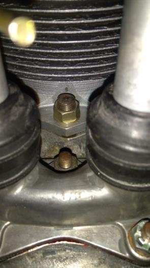

Brief Description:  Cylinder Nuts
I installed the flanged cylinder nuts. Some took a lot of time because mounting the cylinders, The tip threads of some of the studs were touched. At least 8 out of 24 nuts did not want to go by hand. Also, the special wrench I bought from Aircrft Spruce had walls too thick to go in between the nut and the cylinder recess. I had to re-work (file) the wrench. See: picture.I did not torque the nuts yet.
Most difficult to install.
1/2
1/2" wrench re-worked.
All flange nuts in place.
