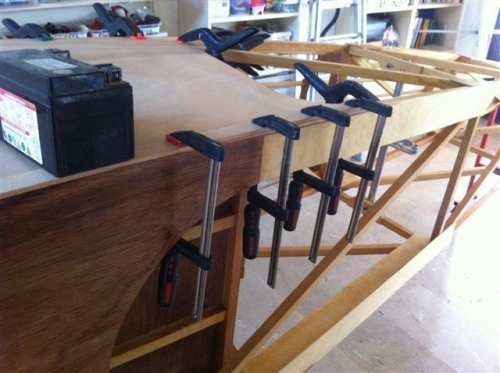

Brief Description:  Left side ply
We cleaned and prepared the left (Port) side of the fuselage for epoxying the 3mm plywood. We trial fitted the ply and checked all the surfaces mated. We removed the weights, clamps and the ply. We applied West epoxy mixed with microfibers and glued the plywood in place.
Trial fit
Trial fit
Ply in place
Ply in place
