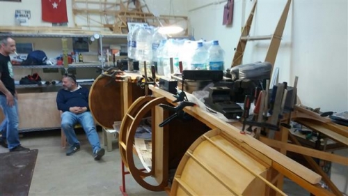

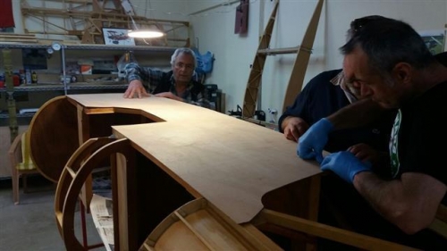

We prepared the fuselage for epoxying the right side plywood (finally). First we dry-fitted the ply to check where to position clamps and weights, when I was confident that all the faces matched, we glusd the side in place. We used a lot of weights of all kinds.
Dry fitting
Dry fitting

Weighed down
Weighed down
