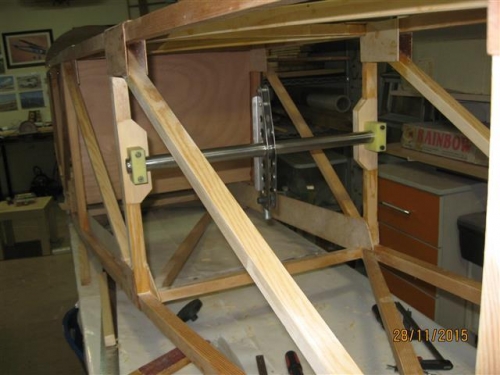

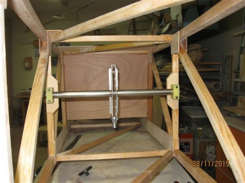

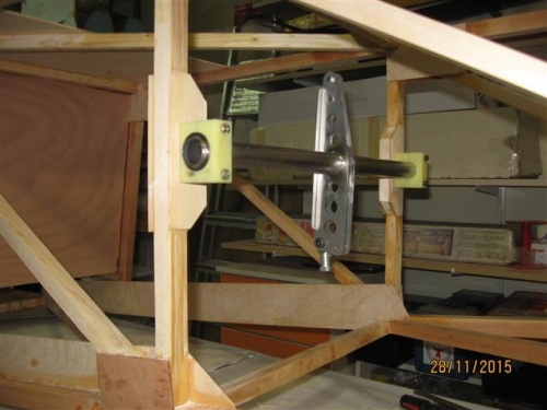

Burak and I worked hard to install the elevetor bellcrank in its final position. It was hard work because my bearings are not self aligning. We had to make the mounting surfaces almost perfectly true.
