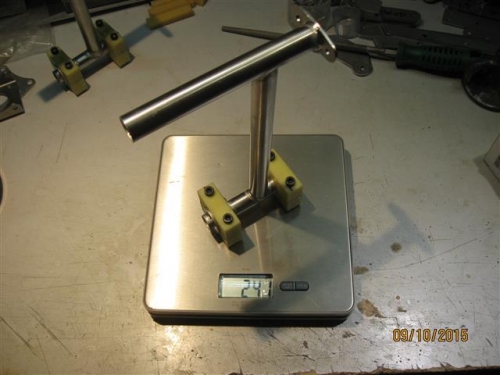

Rudder pedals
I finished welding and pickling of all rudder pedals. Together, they weigh less the one kilogram (including bearings). I hope to check the against fuselage tomorrow. Pilot's right rudder pedal weighs 241 grams (8.4 oz).
Right pedal set
Weight of pilot's right rudder pedal
