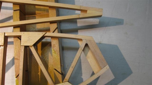

Brief Description:  Guesset defects
Final checking the ribs, I found two guessets of which I didn't like the way they are glued to the ribs. One was a leading edge guesset, curiously, the other one was a trailing edge guesset. I removed them carefully and re-sanded the ribs. I will make new guessets and epoxy them in place.
Bad guessets removed
