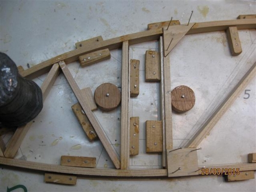

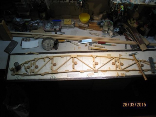

Rib #29
I worked a little more on rib #29 (Left wing butt rib). Since the spar bay will be 4 mm wider (2x2 mm) I added 2 mm balsa spacers to the jig. This is to take care of extra 2 mm ply to go under the joiners.
More work
Spar bay (2 mm wider)
