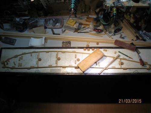

Brief Description:  Finishing the ribs
Today I started #29 rib which will be one of the outer panel butt ribs. The difference from the other outer panel ribs will be the width of the spar bays: 2mm wider on each side to compensate for the 2mm ply bases for the metal fittings. After this one, only one more rib is left to be built, same for the other wing panel.
#29 rib
#29 rib
