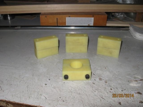

Date:  3-26-2014
Number of Hours:  1.20
Brief Description:  More bearings

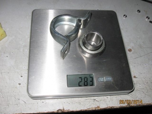

Today I machined the outer dimensions and mounting holes of the remaining 3 bearings (2 for stick torque tube, 2 for elevator bellcrank). Weight of one bearing is only 47 grams (1.56 oz )versus 283 grams (9.43 oz) of the same size metal PP205 bearing.
Other bearings
Other bearings
47 grams
47 grams
283 grams
283 grams
