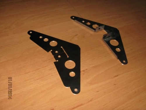

New horns
This time everything is OK. Corners will be TIG welded for strength and washers will be welded on the holes where control wires will be attached. This is for widening the bearing area of the pins.
Elevator horn
