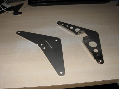

Brief Description:  Some horns
These are the rudder and elevator horns I first cut by laser. When bent, the gap for the connection was 2mm too narrow, so I discarded them.
The horn without the holes is 110 grams 2mm stainless. The bent horn with holes is 88 grams, 1.5 mm stainless.
Horns
Horns
After bending
After bending
