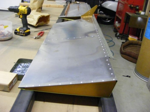

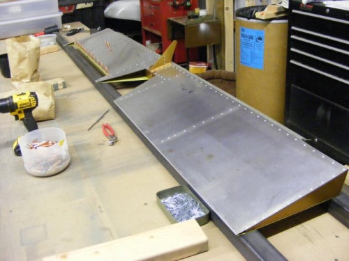

Finished pulling all the rivets in the top skin. A5 rivets between first two center ribs
Leave clecos in 6-T-6-3 for hinge install next.
Verify elevator sits flat on the rails....NO TWIST!
Still sitting flat on the rails
Upper elevator horn complete
Ready for the Trim Tab
