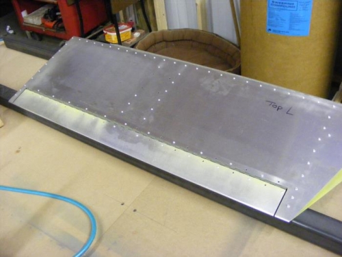

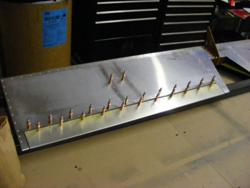

Slid the hinge back between the elevator skin and rear spar and the folded skin of the trim tab Cleco'd every other hole. Checked trailing edge alignment and gaps on the end and started riveting. This is the last assembly of the tail kit, but I don't have enough A4 rivets left.(I'll have to discuss this with the factory) Did anybody else run out? I haven't had any that failed to pull or that I had to drill out, The kit just didn't have enough. I have Plenty of A5 rivets left over???
Plan B. Rivet every other hole, pull the clecoes and install the other later.
STRUCTURAL ASSEMBLY OF THE TAIL CONTROL SURFACES IS COMPLETE.(almost)
Tab Hinge Cleco'd in

Every other rivet installed

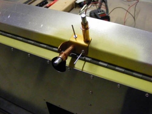

Riveting Tab actuator Horn
