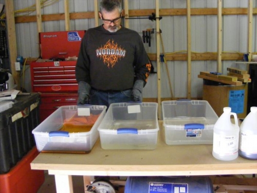

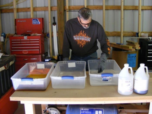

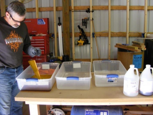

Brief Description:  Alodine Elevator Details
I chose to Alodine all small details. It will be cheaper and lighter than paint type primers. A few minutes in the Alumi-prep to clean the details, Rinse, then into the Alodine for a few minutes and Viola...now just wait a few minutes for the coating to dry and we'll be ready to assemble.
3-4 minutes in Alumi-prep
Rinse in fresh water
2-3 minutes in Alodine(heated)
