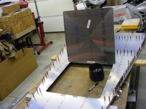

Up-drilling the bottom skin & stiffeners
Updrilling all holes in bottom skin and stiffeners full size.
Start with #40 locating holes, then drill all to #40, and finally the holes in fwd section go to #5

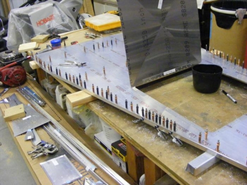

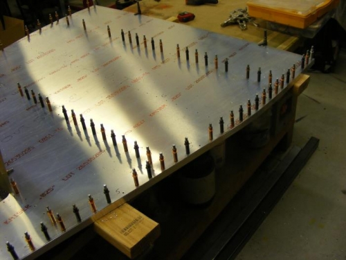

Updrill from #4 to #5
