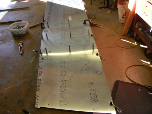

Brief Description:  LOCATING AFT SKIN STIFFENERS
All skin stiffeners have the centerline marked, so all i'm doing here is pressing the vertical stiffener up against the to L, making sure I can see the rivet line and drill the first hole on the end.
Then I make sure the rivet line is visible through all the holes and drill the last hole on the opposite end.

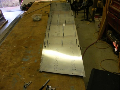

once all the vertical stiffeners are in place, then I can fir the diagonals.
LOCATING FIRST STIFFENERS
ALL VERTICALS LOCATED

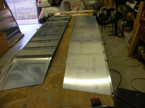

FLIPPED OVER FOR OPPOSITE
