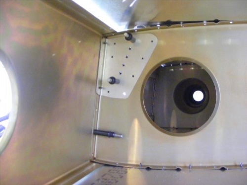

with the tiedown cleco'd to the rib, it was very flexible
I created an L bracket from .050 and attached it through the existing holes in the spar and rib. plus a few extra holes to spread the load.

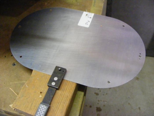

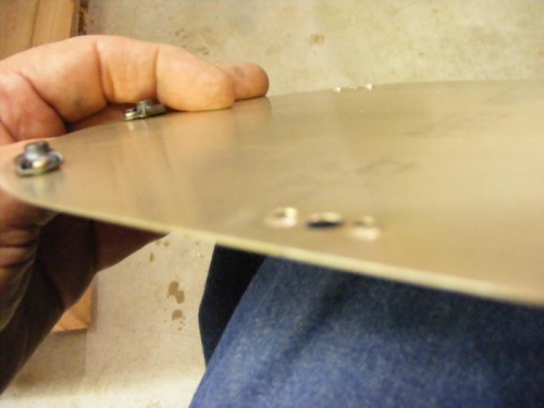

i dimpled the access panel because it was too thin to countersink. The nutplates supplied in the kit are not dimpled, but will still work for an access panel
Support bracket for tie down
Using Nutplate jig
Using Nutplate jig
Dimpled instead of countersink
