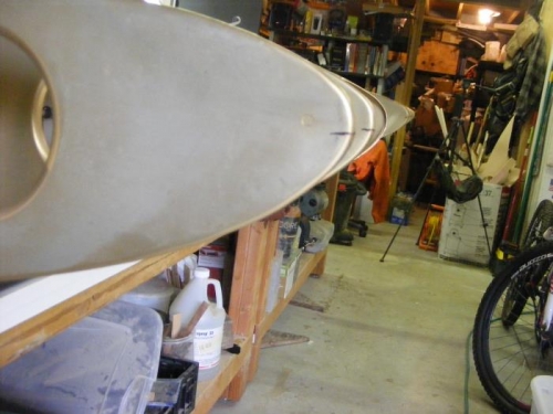

Reinstalled the right wing nose ribs with clecos. marked the centerline of each nose rib.

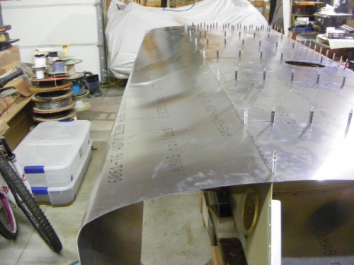

slid LE nose skin under rear bottom skin and align with rear edge of spar cap. Check for sufficient edge distance.
clamp ends to hold skin ant try to pull down to see if center lines are aligned
you can't fully pull the skin down by hand, but I think I have it as close as i can get it until I turn the wing over and put the straps around it.
dtilled the hole in line with all thr rear ribs to lock in position
nose ribs cleco'd and marked

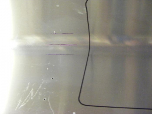

Center of radius marked
pilot holes along star
