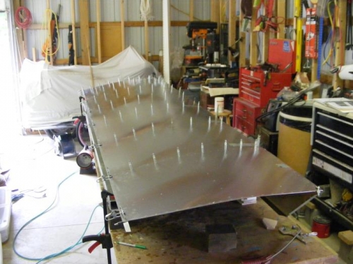

drilling top right wing skin
Drilled all the ribs to #3
drilled from back to front

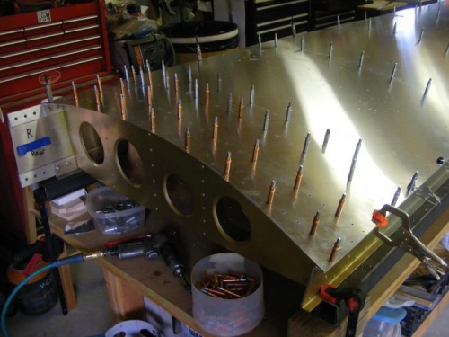

updrilled to #4

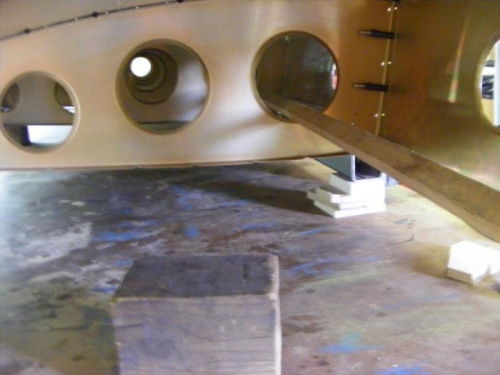

use stick to align ribs
all ribs drilled #3
updrill to #4 holes
