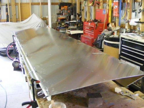

R wing top skin drilling set up

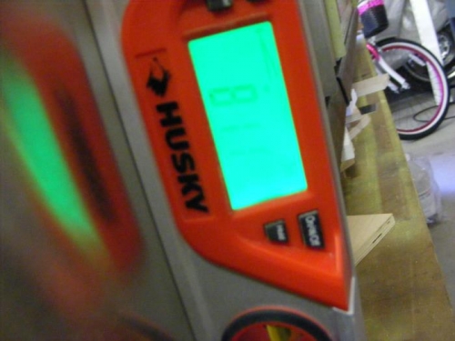

Check level one more time

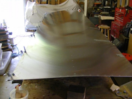

clamp trailing edge, and drill and cleco at rear rib locations
pulled skin forward and used duct tape to hold skin down along front spar
Check level AGAIN
Rear clecos and front tape
