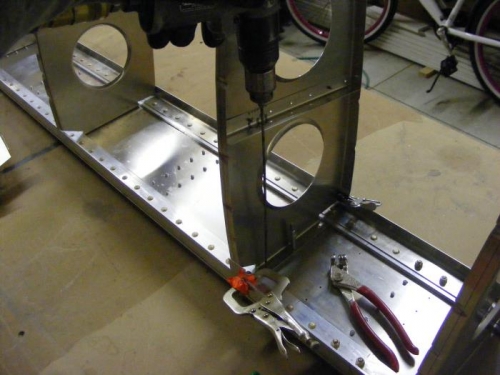

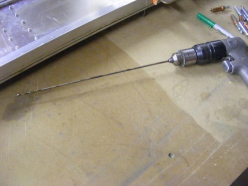

if you don't have a 90 deg drill, a 12" drill bit can be a possible substitute.
the length and flexibility allow you to get the drill moter / chuck far enough away and still be able to drill a straight hole up close to the flange.

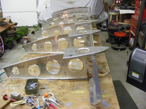

laying out nose ribs in order
12" drill bit, instead of 90*
using long drill bit
Starting nose ribs
