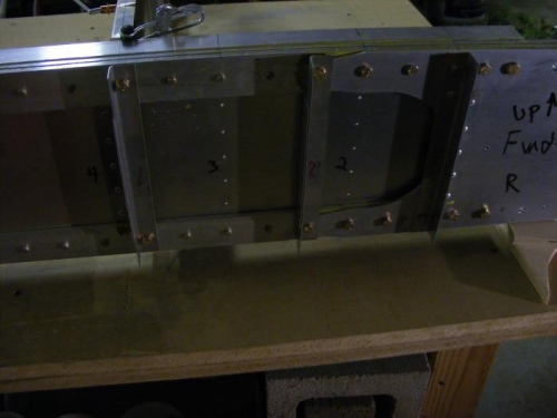

I was about to post a question on the inner web for how everyone located rear ribs 1&4.
I was contemplating unbolting the doublers to access the factory holes, then the lightbulb came on

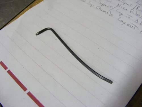

I made a little scribe tool out of an old allen key. I clamped the rib to the spar and used the little scribe tool to mark through the factory drilled holes in the spar.
Doublers covering rib holes
old Hex wrench
old Hex wrench
New Scribe tool, Viola
