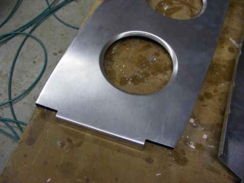

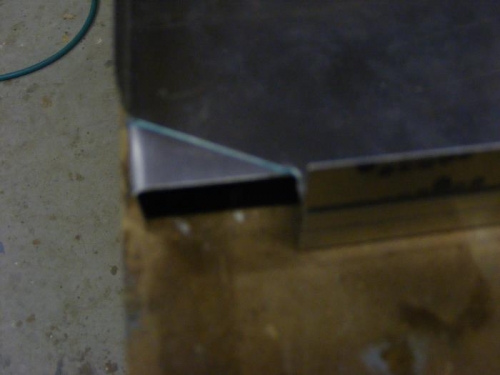

Mark rivet lines, trimmed notch on ribs that the factory didn't
drilled ribs through factory holes in spar
notch missing
used opposite side as pattern
