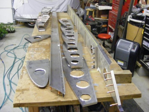

Wing Rib lay out on spar
Started fitting the rear ribs to the front spar
Marked rivet linea and drilled thru factory holes
Ribs 1&6 needed the top notch cut. Some ribs need hammered on the ends to fit/match the spar
Lay out Ribs in order
Mark rivet lines on Spar
Rivet lines on Ribs
