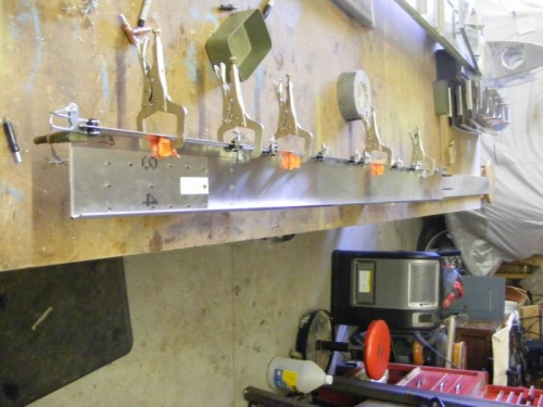

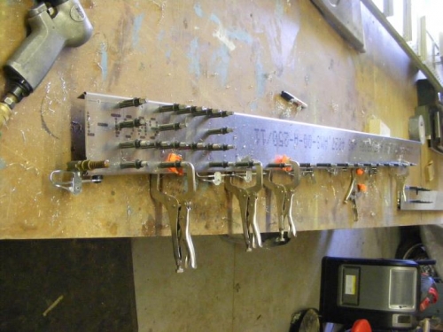

Drilling all doublers to rear spar
Pay attention to the prints
Clamp everything securely
Make sure you use proper edge distance for overlap of 6W11-20

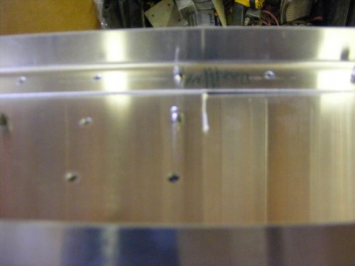

I think the L's should have a joggle in them to reduce the gap area
clamping L's to top web of spar
Rear spar turned over to drill
I think this should be joggled
