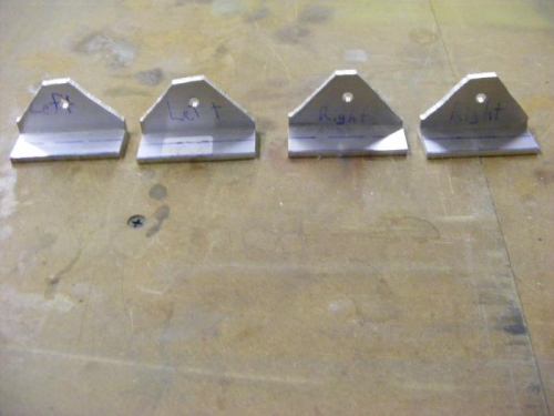

Aileron bell crank support
Match drilled the supports, then rough cut on the band saw. Cleaned up edges on sander

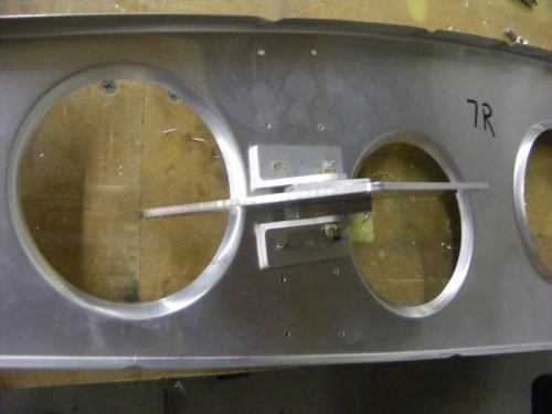

Made spacer block from plywood and scrap sheet metal to set gap between supports when clecoing to RR#7 and 6W6-10
Removed spacer block and inserted belcrank assy to verify everything is tight, but moves freely

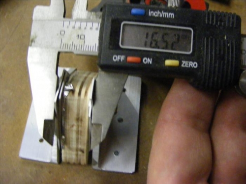

Drilled and rough cut 6W6-11
Verifying spacer block thickness
drill / cleco & test fit
