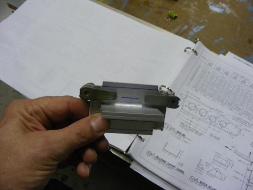

Finally, got started on the wings.
pulled all the parts from the list/drawing.

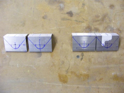

Layed out the drill and trim lines for the bell crank supports.
clamped together so they could be held together in drill press vise.
drilling together ensures the pivot hole is square and true.
Getting everything ready on R Wing
Bellcrank support lay-out
Clamped for drilling
