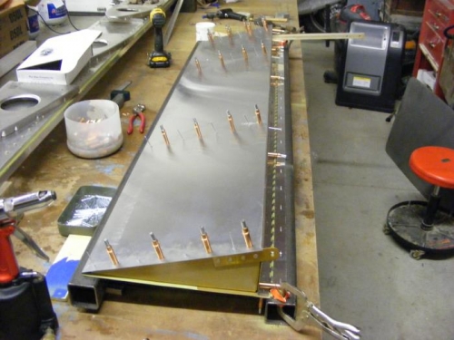

Completed Left Aileron riveting of the hinge.
I put solid -5 rivets in every other hole, but didn't like how it puckered the skin on the edge, so I pulled the other half . looks a little weird, but is solid

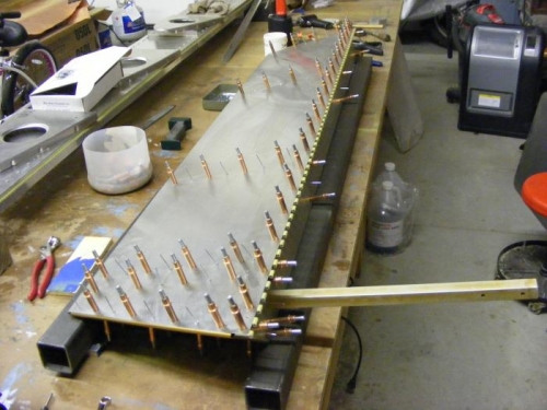

R aileron is same process as the left, without the trib tab details. Rivet everyother hole on one side, pull the other half of the cleco's. Then flip aileron over and repeat on bottom side.
Left Aileron complete
R Aileron ready to rivet top
R aileron ready to rivet bottom
