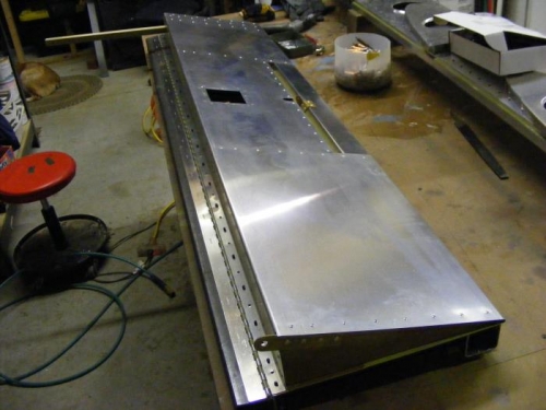

Brief Description:  Finish riveting L aileron
Finished pulling rivets in bottom skin

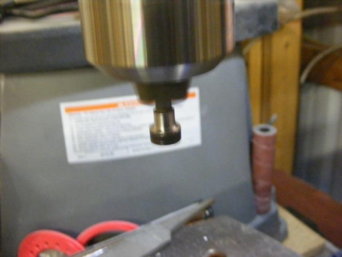

I wanted to use solid rivets for attaching the hinge, but my squeeze set was too tall, so...
I needed to remove some of the base under the head. I chucked it up in the drill press and used a file while it was turning to remove the material.....worked like a charm.
finished riveting bottom
Turning down squeeze set
Almost there
Almost there
