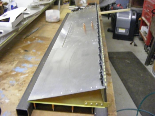

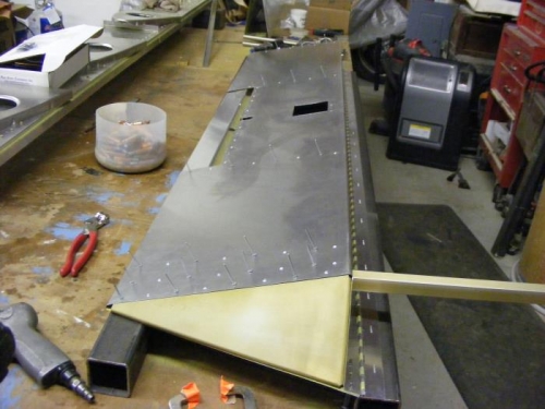

Brief Description:  Riveting Left Aileron
Cleco's every other hole and pulled the first half of the rivets
then pulled the rest on the top skin.
put 13mm spacer back under the rails to make sure the factory twist is maintained
flipped the aileron over and pulled the rivets on th bottom in the same manner.
Anyone notice what's wrong in the first two pictures?
I mis-read the drawing and drilled the aileron hinge rivets to A5. THe aileron hinge half is supposed to be A4, the wing side only is supposed to be A5.
Maybe no-one will notice.
