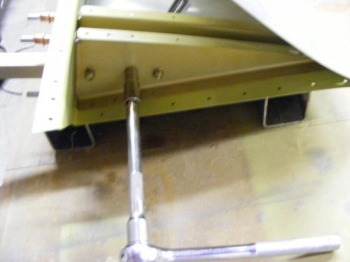

Re-assemble left aileron
You have to tighten the nuts on the balance arms before closing the top skin.

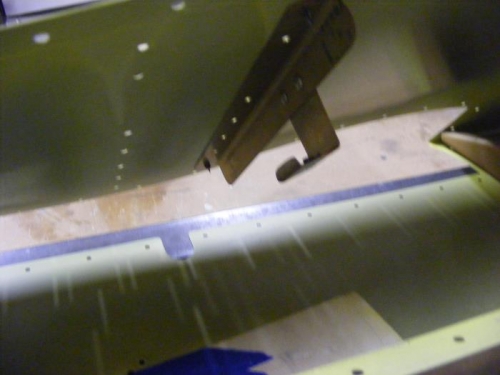

I wanted to secure the servo harness with something other than the grommet, so I
made a custom bracket that will hold a hand made P clip with a screw and nutplate.
I riveted it to the L bracket under the Servo.
I used solid rivets to attach the control hord...my Preference.
Torque nuts on balance arm
custom bracket
custom bracket
Solid rivets in Aileron horn
