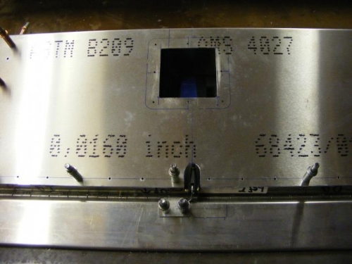

Brief Description:  Aileron trim tab servo access opening
Finished trimming up the access hole for the trim tab servo.
Connected the rod and located the servo on inside of upper skin. Used 6" drill bit to drill holes

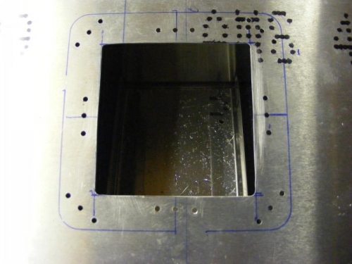

I plan to use nutplates and screws for the access panel.
nutplate jigs are a neccessity! money well spent, time saved.
Servo in opening
Servo in opening

Nut plate holes drilled
