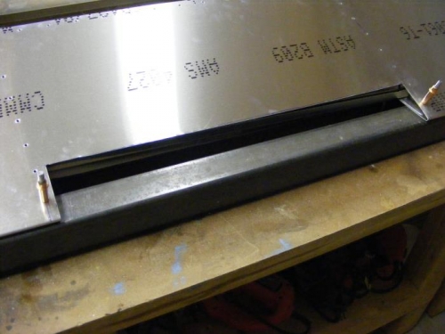

Did alot of sanding and filing to get the opening just right,
Fitting the channel was a chore. Once positioned it was not the same height as the ribs.
I made a shim for each corner to help to help the skin transition without a big joggle in the corners
I did not see any dimensions on the drawing for where to locate the servo, so I put it on the center line.

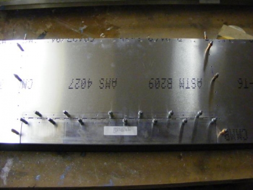

Tab opening final trim
Tab fitted to channel

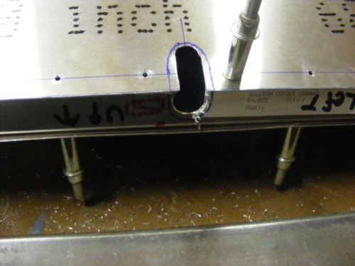

Rough opening for control rod
