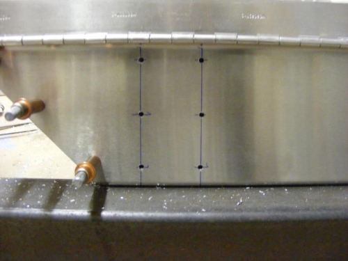

Brief Description:  Aileron balance arm cutout

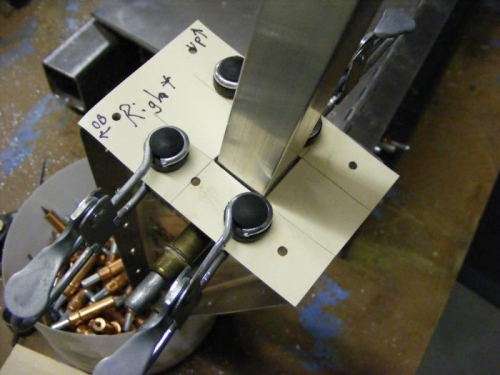

Here is how I located the hole in the leading edge of the aileron.
After locating and drilling all the holes for the balance arm ribs, I opened the skin and pulled out the ribs.
I cleco'd the ribs to the balance arm and created a template from a manilla folder. Then cleco'd the template to the front of the aileron and trancfered the hole location.
Viola!
Balance rib front rivet layout

Template creation
Template creation
