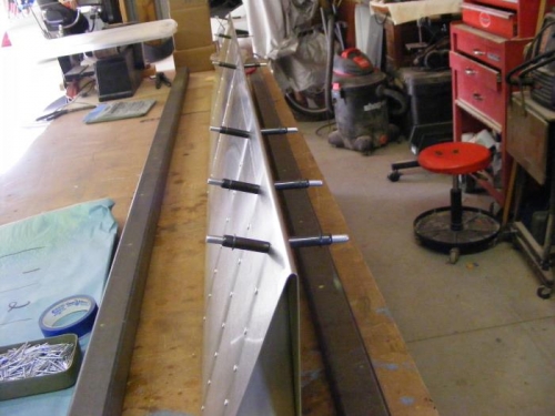

Riveted everything except the trailing edge.
Since I had issues with riveting the R/H trailing edge I did th L/h side a little different
I put both rivets in the trailing edge and made sure they would both fit before I pulled any of them
A few I started with the hand riveter to make sure they would seat to the skin.
The process worked, I didn't have to replace any of the rivets

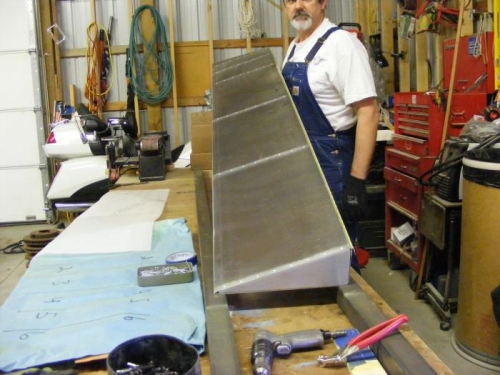

Both Flaps complet.
Still can't seem to get th frame right to take a selfie.
