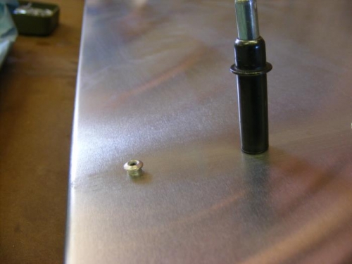

I had 1 rivet along the trailing edge that did not seat properly. It was sticking up, but I thought it would seat as I pulled it with the air riveter.
But.....It didn't.
I drilled off the head, sanded the shank down to the skin, then gently punched it out.
I had to angle it slightly, and started pulling it with the hand riveter. Once the head seated on the skin, I finished pulling it with the air riveter.

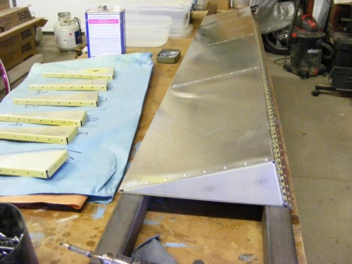

Flipped the right flap over and finisfed riveting the other side.
Rib details for the left flap are ready to be re-assembled

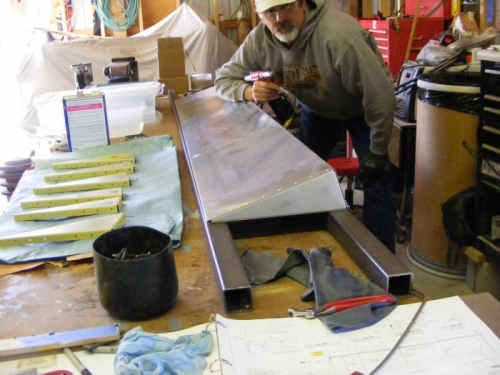

I really need to work on my timing pictures. I always seem to cut my own head off.
1st bad rivet.
1st bad rivet.
Right Flap riveting finished
Posing with my
Posing with my "master piece"
